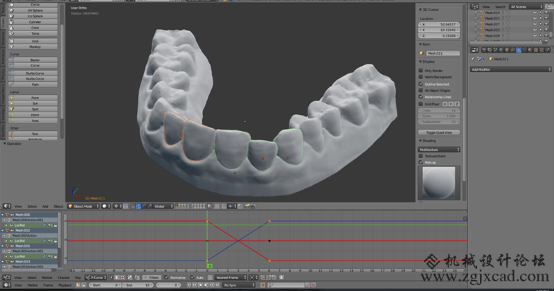

        The process wasn't exactly easy. He had to research orthodontic procedures and plot the route of his successive braces, so his teeth would move in the right way.
        制作牙箍的过程并不简单。他必须研究牙齿矫正的步骤,绘制好相继更换的牙箍的制作方法,这样他的牙齿才会以恰当的方式长回去。

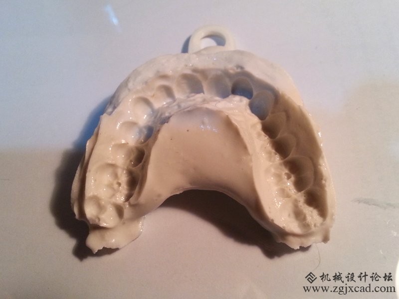

        First he took a mold of his teeth with alginate powder. "These molds are very precise, and capture an amazing amount of detail," he writes.
        首先他用海藻酸盐粉末制作了一个牙齿模具。“这些模具很精密,捕捉了大量的细节,”他写道。
