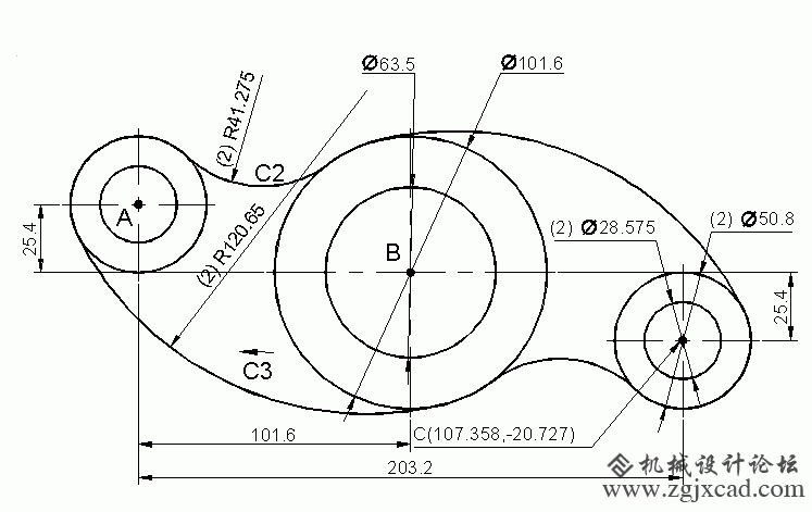

        autocad习题12】
求:
1. C2圆弧之圆心坐标为何?
(A)-49.673,78.186 (B)-49.673,78.086 (C)-49.683,78.086 (D)-49.683,78.186
2. A圆圆心至B圆圆心之角度为何?
(A)344.96 (B)345.96 (C)346.96 (D)347.96
3. C3圆弧之弧长为何?
4. 此图形之外形轮廓线总长度为何?
5. 扣除A、B、C三个圆孔后之净面积为何?
